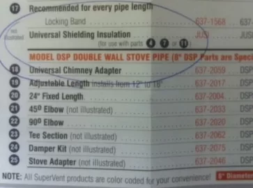

Coverdome, when I first read your post I was thinking you might be referring to the two inch clearance between the outside surface of your class A pipe and an insulation shield that is used in a ceiling situation. After reading additional posts, I notice that you have a cathedral ceiling support.
Take a look at Selkirk Supervent part number "JUSI". In my literature from Selkirk, this part is listed as "Universal Shielding Insulation" for use with their "Attic Insulation Shield", or "Cathedral Ceiling Support", or "Black Wall Thimble". See the attach photo of the flyer; I circled the part. I'm not sure how the Selkirk SuperVent compares with the Selkirk Metal Best, but I hope this helps you out. You should probably call Selkirk and talk with one of their engineers.

+1. I have seen these mineral wool wraps for a competitor's attic insulation guard. But stopped when I came across Selkirk's explicit warning.
Give the mfg a call and let us know what the response is. Better yet, email them and get it in writing.
BeGreen, totally agree with getting Selkirk, in this case, to put it in writing. I am confused, though, why would Selkirk produce/sell an insulation for this purpose in their SuperVent line if it's against their install instructions? Unless it's only for their SuperVent line. In this case, Coverdome is using Selkirk's Metal Best line of chimney.
Best to ask the manufacturer.
Selkirk responded to my email inquiry.
Their insulation product SUSI & JUSI is approved for use with MetalBest Ultra Temp chimney.
It is however, only for use inside the Cathedral ceiling hanger, inside the insulation shield, and inside the thru wall thimble.
Apparently they want it enclosed in something. May have to switch gears on the support to use the cathedral box. Hope Dynamite Buys is good with returns.
Thanks to all for the help & info.
I'm about to purchase a 6" Selkirk Supervent chimney. I called Selkirk today to find out more about their "Universal Shielding Insulation". According to the technical engineer that I spoke with, they have tested their chimney's with this insulation. It goes between the class A chimney and the heat shield. It is used to fill the 2" air gap to prevent or diminish air flow into the attic or out the roof in a cathedral situation. It is also used in the thimble assembly.
I asked the same question a few times and was assured that this insulation product has been tested and approved to be used with their chimneys. I explained that according to fire code, these 2" clearances are necessary. I was again reassured. So I ordered some. It will arrive by mail to my door within a week.
