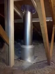

Mine in the attic is hot to the touch with the stove cruising. I will have to shoot it with my IR gun this winter and see what the temperature is.
