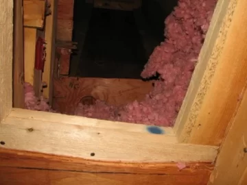

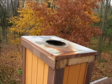

I was looking at that and thinking this design makes way more sense, my issue is how to connect it to the top of the chase which is 3'x2'. Any ideas.
Top picture is of the chase top.
Bottom picture shows the ceiling into the attic then into the open chase. you can see the quality cut and frame job the original installer did of the prefab I'm replacing.

You definitely want to box in the Class A from the under side of the roof sheathing to the sheetrock ceiling below with aluminum or galvanized sheet. You also want to replace the chase top with one made from aluminum sheet & with an aluminum collar that's siliconed in place.That one one your chase now is galvanized & that was what was used 15 - 20 years ago, but you can see that the galvanization has failed & since its thin-walled it'll rot thru. Matt shows you one that you can buy or you should be able to go to a local hearth shop that does install & have them fabricate one that will fit your particular chase top dimensions. I've probably built 25 or 30 of them & they have never leaked...

Thanks for the advice. I did box in the chimney from ceiling to chase with galvanized. Talked to one local shop they only do galvanized custom chase tops so I'll be checking with others for someone who does aluminum. Good to hear on the flashing, picked one up and will install when we get a couple dry days in a row.
