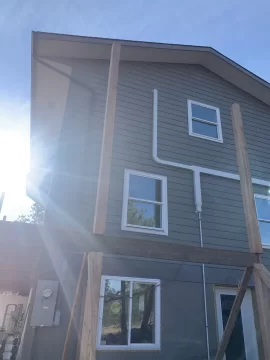

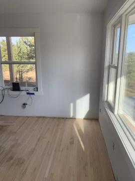

I think we're going to need some pics to see the stove location and outside your house. There are more than several things that have to be looked at.
First, pics of the location where the stove and connector/ stove pipe are going and the exterior of the house where the chimney will be going.

Hi, Attached are the pictures as requested.
The living room floor will be finished by 12/10/2025 and the brand-new Kuma Applewood stove is scheduled to be delivered on 12/16/2025. It will be placed between the window where the router is sitting and the corner of the room, facing straight out. It is 55.5" between the vertical window trim and the corner of the wall. It is a 8' ceiling.
The exterior is the north side of the house and shows the deck being built and the deck will be finished in 3 days. The plan is for the pipe to be attached to the side of the house, going vertical along the rain gutter. The reason the deck posts are so tall is because next summer there will be a roof built over the deck and the posts are to support the roof. The stove is 22.5" W x 37.0 H x 20.375" D with a 6" flue.
