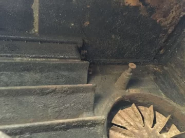

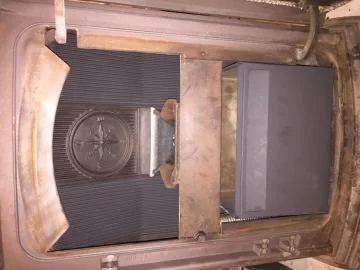

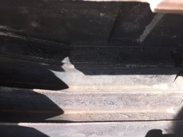

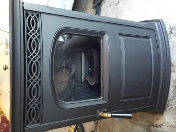

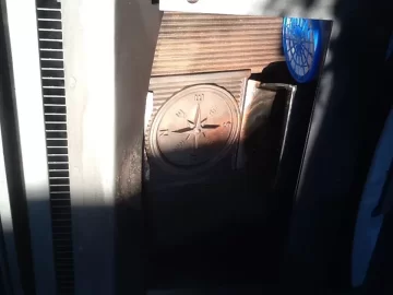

[Hearth.com] Clean that stove! [Hearth.com] Clean that stove! [Hearth.com] Clean that stove! [Hearth.com] Clean that stove! [Hearth.com] Clean that stove! [Hearth.com] Clean that stove! [Hearth.com] Clean that stove! [Hearth.com] Clean that stove! [Hearth.com] Clean that stove! So I started cleaning the accentra today. Wow.. What a difference! As I said the guy I bought it from was in his mid to late 70's. He told me he was starting to have a hard time moving the pellets and getting down on his knees to do the cleanings. So I just got down to it and started scrubbing. I got after it with several size wire brushes, and some heavy duty citrus solvent... The pics should show how good it's coming out. I've got the left interior side just about done, take note of the airwash tube...wow! The right side hasn't been touched for comparison. Can't wait..It's gonna run great!

Looks good! I need to give mine a good cleaning too.. Just did a quick vac out after last season ended.. Have to do a deep clean before this season starts
Looking good. When I bought the used PC45 I enjoyed going all thru it and stuff. I learned a lot and had help here if I had questions. It turned owning the stove more personal instead of a heating unit. Kinda cool seeing the inner workings thoroughly and knowing what makes it tick.
Go thru everything you can and check it all out while it's easy to do. I did mine out in the garage.

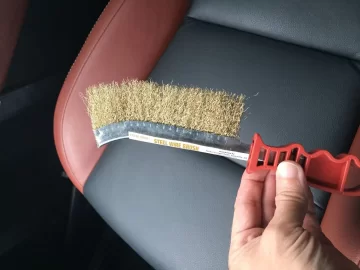

Just picked up this at harbor freight. ... 79 cents! I think it'll work well on the heat exchangers.

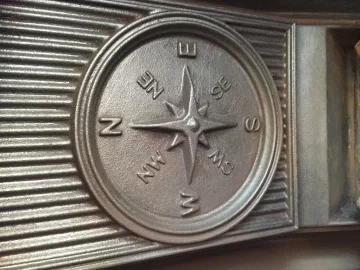

I think the compass thing is neat. I have not seen that or noticed it until these pics. What's the story behind that? Anyone know? Is it or was it an option or standard?
Cool seats in the Rav4 BTW. I bought a new STI in May and the seats look very similar is why I asked. Garage puppy for fun here and there. I'm normally in my trucks most of the time.
Anyway back to the compass detail. Is that only in certain years on the Accentra or is it all of them? It just strikes me as a cool funky little detail. I have always thought compasses were cool. Call me weird.
I bought one of those as well as a great chisel for the burn pot and a pic set to clean the holes in the burn pot. I think I paid something like $10 for everything.

Not sure what's the story behind the compass. But I can tell you I did a ton of looking for my stove and I never saw one the didn't have it. Personally I love it....its a really nice touch.
It must be standard on the Accentra. Pretty cool. I guess I have just never seen the inside of the fire box on an Accentra. I have seen one in person when I was looking for my P68 in the dealer's show room but I didn't really look the Accentra over because I was there mainly for the P68 and had already decided what I wanted.
It is a very nice detail. Kinda wish my P68 and PC45 had it. Looks way better than fire brick. But then again all I really see is fire. Does the Accentra have the reflective glass? My 68 does but the 45 does not. That is also a nice detail because the inside is not seen when there is no fire. Can't have it all........

Hmmm on the Accentra insert the compass plate is removable ( it's fixed on the fs model) and it holds in the left and right side plates. In order to install it properly it goes in north up.....maybe that's why the did it? That my .02 and I'm sticking to it...lol

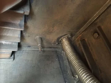

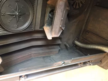

I've been tinkering a little here and there and I'm making progress. The heavy duty scraping and scrubbing is done. All fans and air paths are clean...got 10lbs of crap out of the distribution fan. Cleaned, scrubbed the convection blower cover , gave it a coat of paint. Also painted the ash bin and the 2 side heat exchanger covers. Also cleaned the esp probe and did the air bypass mod. Btw...it looks like the arm will hit the tubing ...it's just the way the pic came out..it clears just fine. Now I've just got to focus on the cosmetic stuff and it'll be good to go.

What exactly is the air bypass mod?

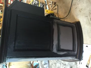

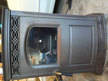

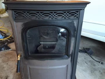

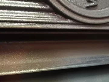

I bought some imperial stove polish and got started applying it. Here's a few before and after pics. I'm impressed!

If you were a doctor, I would go to you.

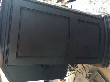

Sooo... She's all done! The imperial stove black worked awesome, I love the way it came out. I'm going to let it dry till Saturday, then I'll fire it up while it's still outside, maybe I'll give it one more coat, but right now I'm really really happy Here's a before and after.
