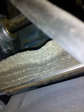

It's a no-brainer that different brands of pellets affect the rate at which it fills up. That top layer is 1 tons worth whereas the 3 darker layers below it are 3 separate tons. Here is a pic of my old P38 after approx 4 tons of pellets of various brands. You can see where I burned a few bags, bought a ton and burned em, ran out and burned a few misc bags, bought and burned another ton....etc.
I was commenting on the pellets/fines ratio. I think pellet length has more to do with the ratio. That is all...
I didn't mean any disrespect mepellet and I apologize if I offended you. I should have worded it differently. It wasn't meant to discredit your idea. It was a statement directed towards the fact some brands contain more fines than others, and that can and does change across brands and production runs.
I do agree with your pellet length theory though. If the pellets, during production, were coming out of the die with that length then I'd imagine some "parameter" was off somewhere and more fines were being produced and bagged directly. What makes even more sense is if there were a lot of short pellets in any given bag, perhaps the bag was over-handled or got damp during S&H and got broken down thus creating the fines that way.
Thats a pretty cool pic given your description.
