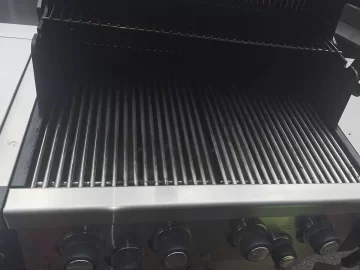

Cleaning BBQ greasy grill grates is alway a hassle! Just touching them leaves grease all over your hands!! First I always get the big stuff off with a grill brush. :)
Therefore there is a way to clean BBQ grill grates like they cleaned the Statue of Liberty with Bicarbonate Soda!! It actually seems to work very well!!
This larger 40lb HF soda blaster has a range of 35-90 PSI so I set the Soda Blaster at 60 PSI using High Flow couplers. :)

Pic 1-2 Stainless Steel grates before soda blasting
Pic 3-4 Harbor Freight Soda Blaster
Pic 5-6 After soda blasting
