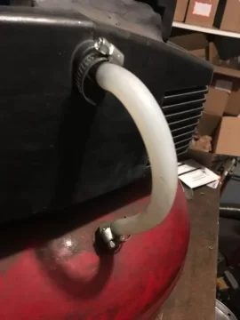

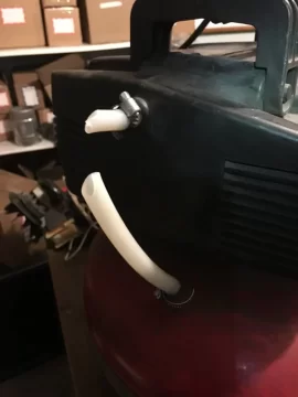

Your ash vac blower is like 10 PSI which pales to compare to a 100 PSI air compressor!
Look what 40 PSI does to a silicone vacuum hose!

Haha...you commented in the thread Bob...click on the link...
