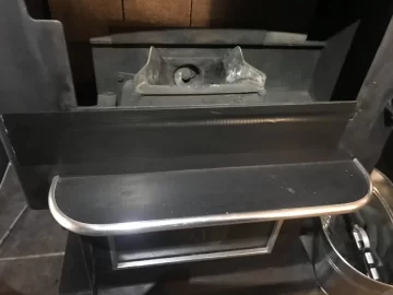

I’ve replaced the door gasket as well as the glass gasket. I’m still seeing possible air leaks on the glass. I’m wondering what my next step would be to eliminating these. You can see in the photos they are from both bottom corners.
To Me and I may be wrong but where the glass is clean is because of the air wash
Where the glass is coated there is no air wash and would not have air wash in coroners
If I am right your stove is normal . But others may correct me

Thanks for the tips...I'll clean out the air ash slot. I'll be back with some photos hopefully.

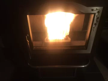

Ok, so did a decent clean on the stove today, duct taped the air wash slot and blasted it with compressed air, vacuumed it and it seems to be keeping the glass clean now...last pic it’s been running since 1pm today so 6hrs and would’ve been dirty yesterday. Thanks for the advice!!

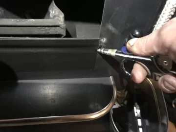

I must be an idiot. You say you duct-taped the slot and then blew it out? Can you explain?
I duct taped the air wash slot and left it open at one end so I could put the air compressor nozzle into it to pressurize it and blow the tube out...I then did the same at the other end of the slot...I also put my shop vac up against the slot while blowing compressed air(not pictured).
[Hearth.com] P61-2 possible air leaks
got it... thanks
