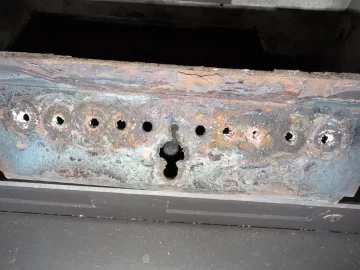

I’ve been posting off and on about my battles with this stove. I’m at wits end right now. It’s still burning out of control with the settings (feed rate 1, combustion blower 3, heat output at 3 and damper at about 50%) the flame is still up the glass most of the time and it’s destroying a second burn pot of the season. I don’t know what to do with this thing anymore. I’ve had a professional come out and check it and they aren’t sure. I’ve tried every combo of settings. I have almost no white ash it’s all black. I clean the stove all the time. Can anyone give me a link to a cleaning video for this stove, can’t find one anywhere, MAYBE I’m missing something cause the manual is so vague about everything. But I sweep the pipe, clean the vents, the exhaust shoot and fan, and keep the bin empty. The company barely responds to me and doesn’t seem to care if this get fixed. The dealer that came to the house even said they can barely get the company to help them deal with these stoves. I’m about ready to replace it if I can’t figure this out, as wasteful as it would be for me to do so, I just can’t get this stove to run right. The photo attached is a burn pot that’s three months old and it’s getting cooked already. Any and all help is appreciated and I’ll try whatever is suggested. Thanks.

From the look of your burn pot, there's too much combustion air
Still using my original burn pot, 12 years ( shop Stove)
