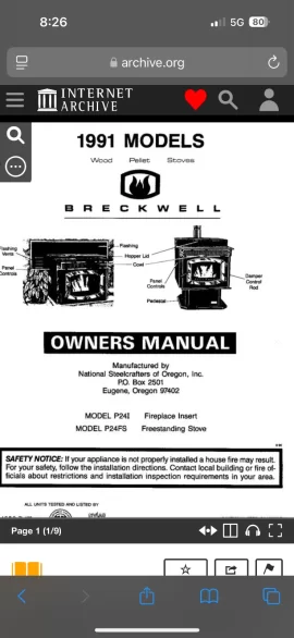

Auger/ feed issue with on old P24 fs (believe it’s the pre 1991 with analog controls, it’s dated as a 1988 model) damn old stove has always worked great with normal maintenance, but it decided to act up.

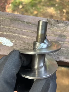

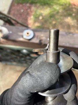

Yeah this old stove is a real PIA to work on and not much room to get behind it and crouch down enough to comfortably work on. After a real fight today I finally got the auger out. Unfortunately I couldn’t get the coupling off of the auger shaft end, and without removing it there’s not enough room to clear the bottom of the stove to drop it out. So after much frustration I snuck in the angle grinder and cut the shaft.
But just as suspected, the slippage was between the auger shaft and auger blades. A real weak skimpy weld broke that locks the two together, surprised it didn’t crap our years ago!
But I might have really screwed myself bu cutting it because mine measures 10.5 inches long, and all I can find online is 10” long auger assemblies. I did see on a listing that if yours measures 10.5” long then you need part number A-AUG-28 but when I search I can’t find any available, I might just be screwed.

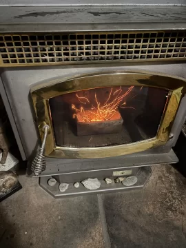

I was able to tap the original shaft out of the auger piece. It’s a 1/2 inch diameter so I was able to get a new piece of 1/2 inch steel round rod from Home Depot. I cut it to length and drove it Into the auger piece. In a pinch to get it back to blowing heat and I don’t have a welder so I drilled 4 small holes spread out through the auger piece and into the round rod a little ways, then I was able to use some short screws that bit pretty well to serve as set screws so there wouldn’t be any slippage. Got it back together and dropping pellets again just fine, I think the bush fix will hold up just fine but time will tell. Moms house is warm again so glad to scratch this one off the list

It’s great you have a mechanical mind, what ever it takes. Make it work. I scrapped all the old Blackwell parts, so its just as well you had a fix👍
