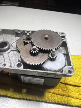

here is a pic of the plastic gear inside a unit that was never taken care of, i pulled this week. any gear in the box strips or looses teeth it is useless. the white gear is plastic the rest are cast pot metal that have been machined. and yes i cleaned out the grease

I've replaced one already with a stripped gear. While I haven't yet taken that one apart to see what went wrong, I've repaired enough gear boxes to know that when the input motor is working as it should, and the out-put shaft isn't turning, that you have a gear problem. Actually, I can't complain about that gear drive because it was the original that came with the stove and lasted some 15-16 years. BTW, nice job on cleaning out the grease. (: )
