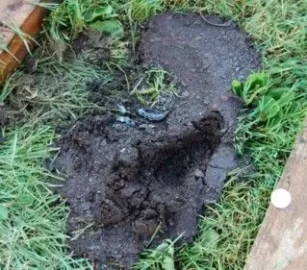

I used the high pressure washer on the inside of one of my tanks yesterday afternoon. It worked well and I was surprised at how much gunk came out. I’ll bet I could have filled a quart jar with it. The tank looks good inside now but I will still install some kind of filter in the system. It was no problem standing the tank on end outside but I have yet to figure out exactly how I’m going to stand it up once it’s in the building. They won’t go through the door vertically. A combination of chain hoist, block and tackle and a comealong I guess. Any tips would be appreciated. The picture on the right is the gunk. That’s a quarter lying on the 4 x 4 for size reference. I’m guessing I’ll get that much out of the other two tanks also.
