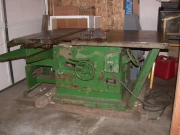

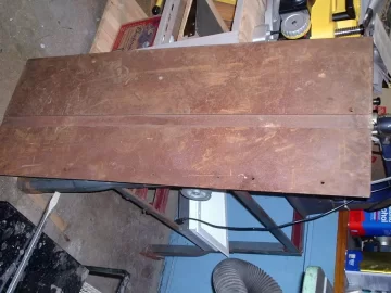

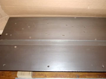

    Electrolysis ain't expensive. Here's the rolling table from an Oliver table saw, for reference.
    Before:
    After:

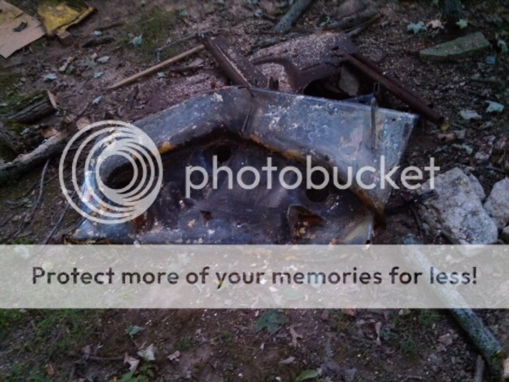

    Note, this works quite well on large items:
    I'm not sure if this is what salecker was referring to as "the expensive method," but I can assure you it's not. A few cents worth of electricity, a few cups of Arm and Hammer washing soda, and a bit of scrap metal (or rebar) is all it takes. Probably costs less than his WD-40 and emery cloth... and certainly does a nicer job. Once I fired up my first tank, I kept finding other stuff I wanted to stick in it, as the tank does all the work for you.

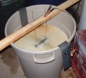

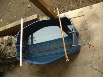

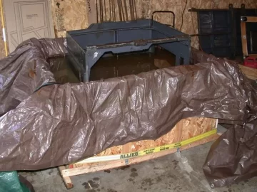

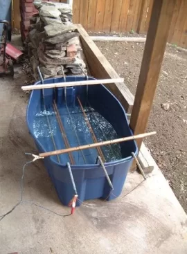

    Yes! Get some plywood, 2x4's, and 6-mil polyethelene, and build yourself a tank like the one I showed above! I've built a few tanks, and it's always the best / easiest way to go, for big stuff like that. I know one guy who built a tank large enough to do his flatbed pickup.
    Here's how I generally do small stuff. Those scraps of plate steel hanging from the edge are the sacrificial anode. The parts being cleaned are hanging from the copper wires suspended by the scrap of 1x3 lumber (I use a copper pipe instead of the lumber, and rebar in place of the plate steel, these days). I still use that same trash can, 32 gallon.
    Here's how I did some longer parts, one time. Rebar is sacrificial anode, good parts are hanging from the copper pipes. Note that all anode wiring must be made OUTSIDE of the bath, which is why I always bend the rebar/anodes to make connection above the water line. Cathode (part to be cleaned) wiring can be used below the water line.
    I thought I had some photos of some of the large tanks I had made for doing a floor standing drill press or big bandsaw wheels, but can't find them now! Basic proceedure is to build the box, lay in the sheeting, put a few inches of water in the box, get the plastic sheeting arranged more nicely (staple perimeter above water line), fill the box, carefully set something in to support your parts and anodes (without tearing plastic), and you're good to go!
    Electrolysis is mostly a line-of-sight process. Parts that are not line of sight will eventually get clean, but they take much, much longer. So, it's best to arrange an array of anodes that will give you line of sight coverage to your entire assembly. The trade-off is that you cannot exceed the current draw capacity of your battery charger, so if you use the typical 10 amp charger, you're usually looking at roughly 3 - 4 pieces of rebar, 3 feet long each, before you're at the charger's limit. You can parallel multiple chargers, though (keep anodes in separate clusters, tie all cathodes together on part to be cleaned), or go to a bigger charger (just be careful to not kill yourself). I have seen stories of people experimenting with DC stick welders, but I would not advise this.
    Also, be damn sure you maintain a good anode, as well as a good connection to the part to be cleaned. I have seen stories of a anode connection failing, and then the most poorly-connected part of the anode behaving as the cathode (bye-bye good parts!).

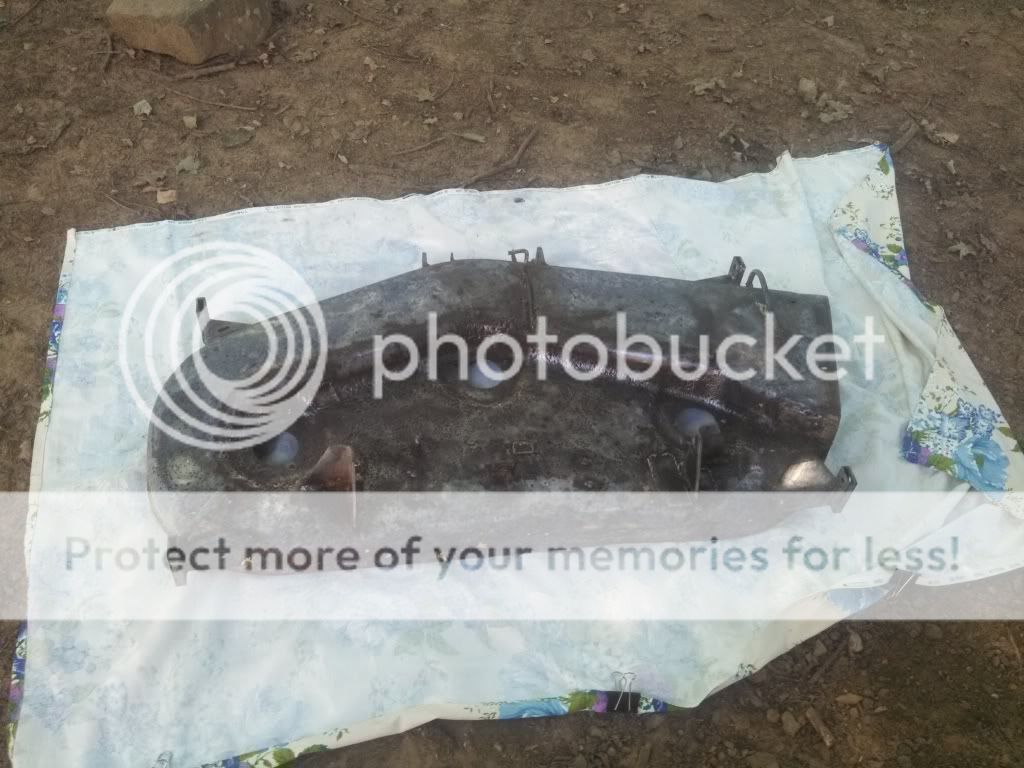

    Made some progress here...
    To construct the temporary tub I used my old log sled as a frame and made walls out of old poly iso insulation and some plastic shelves. I lined the tub with a big piece of epdm rubber I was using to cover a wood pile. Determined to do this as cheaply as possible, I scrounged some rusty sheet metal from the woods behind my house to use as the anodes. I was going to suspend the mower deck from a ladder stretched across the tub, but figured it was easier to just rest it on some blocks and 2x4s on the bottom. Calculated 3' x 5' x 1.1' x 7.5 gallons/cu ft = 135 gallons = 8 cups of washing soda. Hooked it up with the 2 amp charger first to make sure it worked and then switched over to the 40 amp... now it's bubbling away at 25 amps.

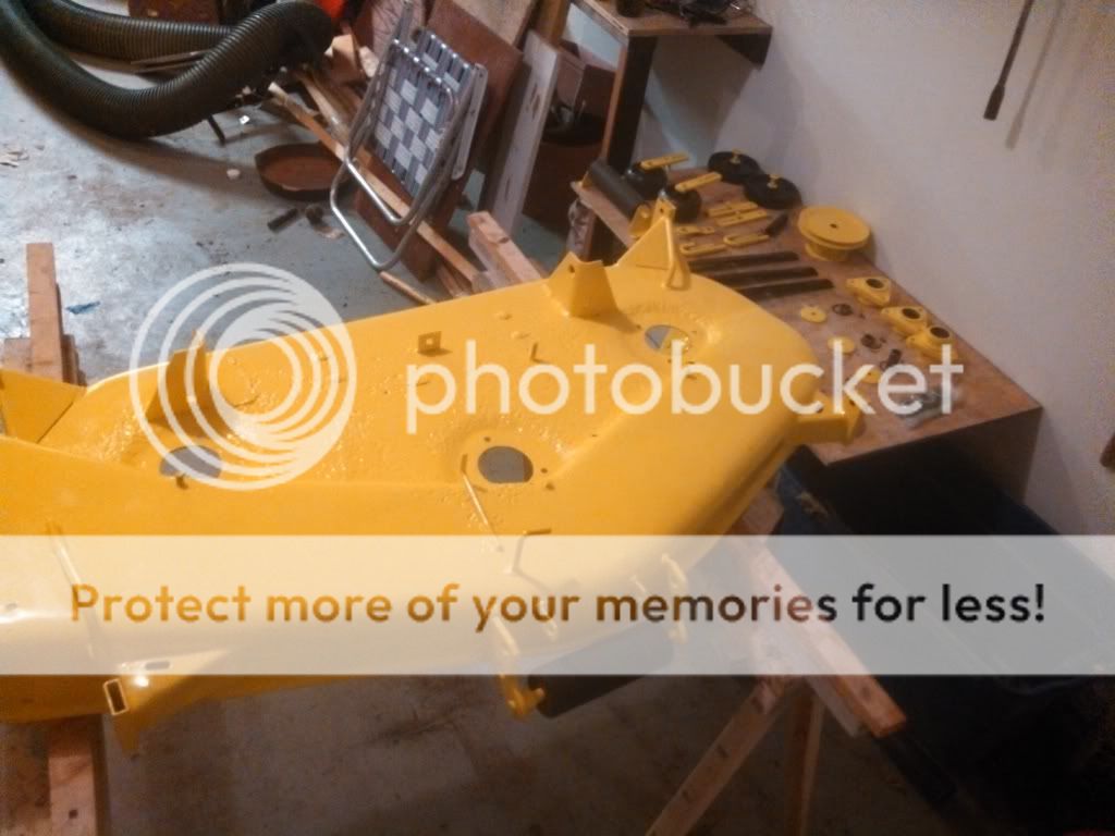

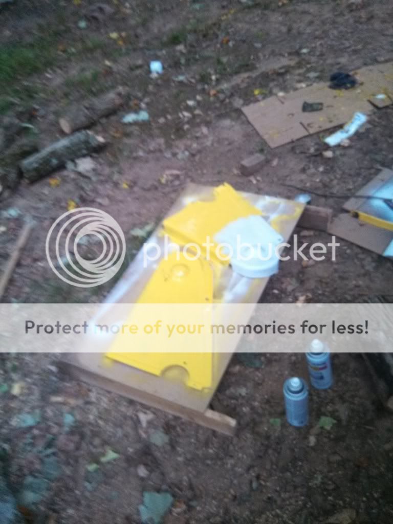

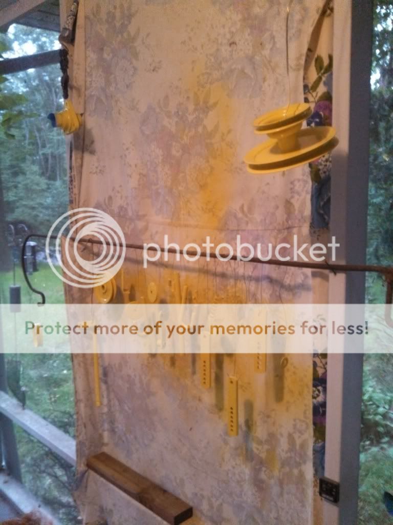

    After the de-rusting everything got a coat of Rustoleum spray primer followed by two coats of Rustoleum JD Yellow spray paint.
    [​IMG]
    [​IMG]
    Here it is back where it started, ready for reassembly.
    [​IMG]
