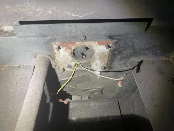

The Harman P61 has not been used in the past 4 years and the Burnpot and Burnpot Gasket is a little grundgey!
Using a blasting cabinet with a little white aluminum oxide and 25 CFM Quincy compressor seemed to perk it up a bit?
[Hearth.com] Cleaning up a Harman pellet stove burnpot with white aluminum oxide. [Hearth.com] Cleaning up a Harman pellet stove burnpot with white aluminum oxide. [Hearth.com] Cleaning up a Harman pellet stove burnpot with white aluminum oxide. [Hearth.com] Cleaning up a Harman pellet stove burnpot with white aluminum oxide. [Hearth.com] Cleaning up a Harman pellet stove burnpot with white aluminum oxide. [Hearth.com] Cleaning up a Harman pellet stove burnpot with white aluminum oxide. [Hearth.com] Cleaning up a Harman pellet stove burnpot with white aluminum oxide. [Hearth.com] Cleaning up a Harman pellet stove burnpot with white aluminum oxide. [Hearth.com] Cleaning up a Harman pellet stove burnpot with white aluminum oxide.

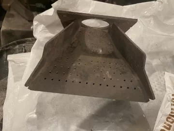

Here is the new burnpot gasket and burnpot installed and stove working like new!

That cleaned up nicely.
Curious, have you ever tried polishing the pot? Especially the areas where they build up the carbon more. Thinking that nice smooth polished surface would be easier to clean and less build up.
Hello
That is an idea but the burnpot has a very hot fire in it that would destroy any polish. What did you have in mind?
I think even if it was lapped you’d still get the speed bump 😉
Maybe a fuel stirrer rod or Versa Grate would help? I think our speed bump would be a lot worse if we did not have Selkirk DT :-)
