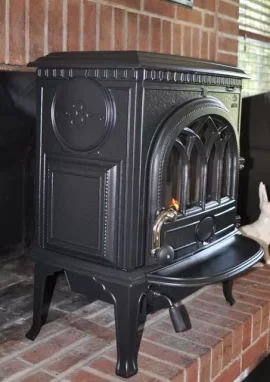

My F3cb sits on the mantle , the lintel is 3/4 of a inch above the stove pipe . I don't think there is a minimum for the stove but I do recall a minimum for the stove top to a combustible mantle ( 3'-0" ? ) . We had to remove the wooden mantle to meet this criteria . I included a photo so you can see how it sits we did have to purchase a hearth extender ( 18"x48")to meet the code . So far we have really enjiyed the stove and the warmth it provides .
