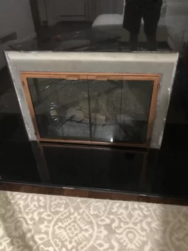

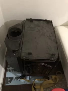

Thank you all in advance for the great help and info on this forum, I have Cumberland gap that I want to place into my fireplace:
1. Is clearance will be an issue in case it’s in the fireplace, it will be only few inches away from the back of the fireplace (2 or 3)
2. Sides will give me 4” away clearance from each side.
3. It will stick half way out but no mental, is the marble wall above it is a concern? Top of stove only 1.5 inches away from the entrance of the fireplace (no hight issue inside the fireplace)
Thank you again
