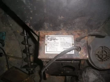

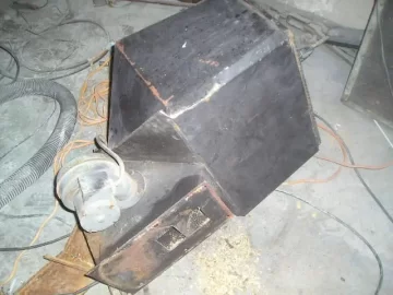

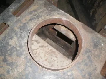

got it torn down some, but here is what I'm working with.... Collins 4000. Merkle auger motor and solid state timer ckk-60-461.... Anyone with any info on these units????? Any suggestions for optimum heat??

Is that a combustion blower on the hopper? If so, is this a positive pressure unit (most old ones were)?
Make sure all your gaskets are in good condition (replace) and your flue is sealed well.
Yeah, it appears to be a positive pressure stove. Yeah, definetly going to replace all the seals and exhaust pipe...

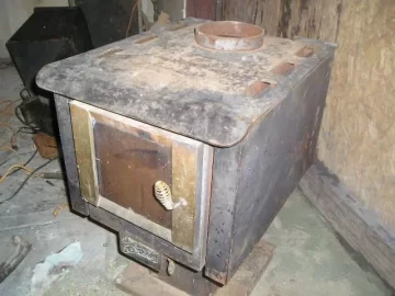

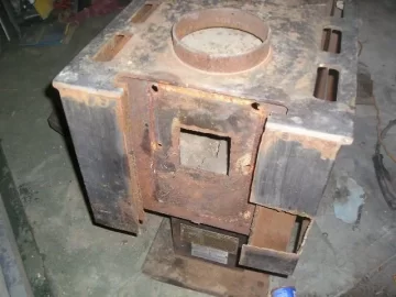

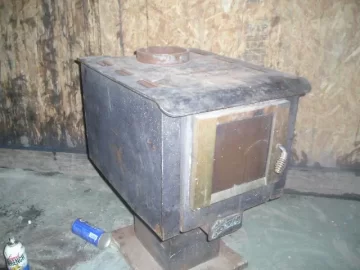

Any pics of inside the firebox? I am intrigued by this stove. I hope others come along that know more about the particular model. IRRC, Webbie has seen/sold some Stoves like these. There were old threads on some old pellet stoves. Try using the search up top?

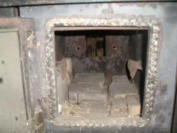

Yeah, I can get some pics of inside stove... Some bricks are broken, so need to replace, but have everything it looks like to work... I too am intrigued by this stove and it's now become a challenge to get it going!!! Have not found hardly anything on the Internet about the Collins Hopper.....

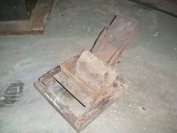

As I said, going to need new bricks.... Also flue hole has big thick metal plates ( in pics you can see) that slide to slow or speed up outflow... Tray is actually in decent shape and holes are all open and looks clean for airflow..

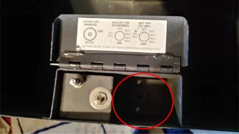

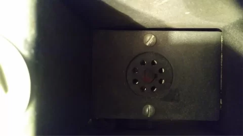

I'm hoping to find some more information on the Collins Hopper 4000. I did my best Google-fu but couldn't get much more than a few mentions of it being the first pellet burning device and also an obituary for the inventor, Loren who passed away just 4 months ago. My main question is what switch controls the auger speed? I seem to be missing something in my electric controls. I've enclosed some images of what I mean. The first picture is of the controls with the area I zoomed in on circled in red. What goes here?

I could be wrong,but,the collins were conversions for wood stoves,and,possibly for wood furnaces.There also was another manufacturer that did the same thing.No combustion blower was ever added,so full size wood stove flue pipe was required.Their efficiency was not good,even though they worked OK.To run one nowadays means you have more money to burn.But,one would be a collectors item,for people that collect that type of stuff.A cheep farm store stove would give you more heat,and have better burn control.But,it is a classic, for a small part of our country.
