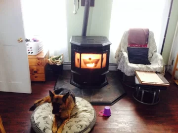

I would start with the venting first cleaning the blowers will help . Cleaning the venting is pretty easy . If you have a photo of your setup that would help . Based on how you described it you could either go from the bottom or top if your comfortable on a ladder .

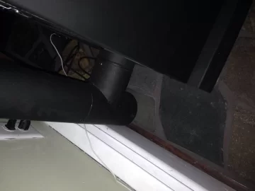

From the back of the stove I have a 4-5 foot rise, then a 90 elbow through the wall to another 90 outside which then rises up another 4-5 feet before you get to a 45 elbow and a cap.
The bottom of my clean out tee is only about 2" off the pad though. It's hard to access.
Attached is my inside setup, I'll post outside when I can.

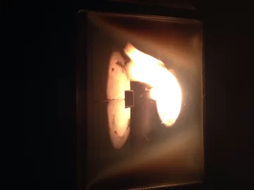

This is how the flame looks, even with the feed gate 3/4 of the way closed I get this tall lazy flame that licks the baffles and covers them with soot. The heat exchanger tubes soot up too and I need to clean them daily if I want any decent heat output.
