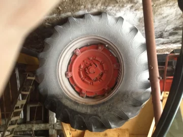

Our tractor tire had frost coming out from it too. They are filled with a saltwater antifreeze. You can see the level with the frost line [Hearth.com] condensation
Ha! That too funny the photo posted upside down

Our tractor tire had frost coming out from it too. They are filled with a saltwater antifreeze. You can see the level with the frost lineView attachment 123711
There goes my vertigo again.
I takes talent to park the tractor on the barn ceiling
