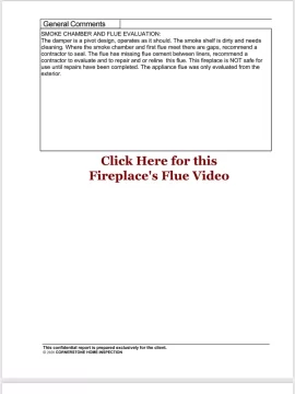

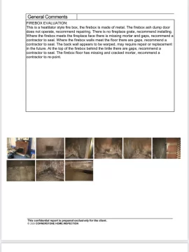

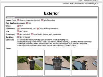

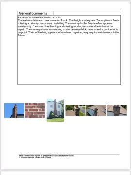

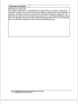

I recently purchased a home with a chimney...it is used for both a wood burning fireplace and the furnace. one of the caps was missing so I had it replaced and had them look at the chimney as I was aware it needed mason work at a minimum. I must add I do not ever plan to burn wood as my son and I have asthma. The guy who capped the chimney said not to use the fireplace (not an issue). He said it needs a lot of work up on the roof and that the liner is not the correct size for the furnace I have. He also said the size I need for my furnace would not fit in the current chimney. I explained I’m in the process of replacing the furnace and he said to get the specs and he will try to help. My plumber insists there is no issue and the furnace has been there using that fireplace for 30 years. Now the plumber is having a disagreement with the town inspector regarding the BTUs so I’m assuming the chimney guy was correct. The plumber is saying it meets code and certifying it. My question is what is the most cost effective way to resolve this as I suspect I will need to make some correction to this fireplace to make it safe to vent my gas furnace. Funds are limited but I need my house safe and I am very concerned about how this can be resolved.

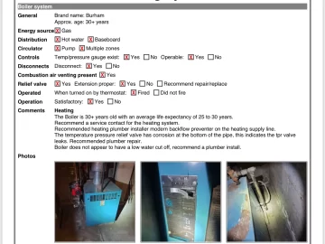

Some details...we recently purchased the home...the furnace was 30 years old and past it’s life...It is a gas furnace being replaced by a new gas furnace...it is located in the basement. The current chimney in the house has 2 compartments...one vents the furnace...the other vents the wood burning fireplace on the first floor. I have an inspection report and video but I believe the video is only for the fireplace flue...I will attach the report as some pics are included. Currently the old furnace is removed...I have a picture of it but not sure that sheds much light and have to find out exactly what product will be replacing it. I have no expertise with regard to plumbing or chimneys so any guidance is appreciated.

The mason I consulted mentioned it may be more cost effective to vent out the side of the house as opposed to fixing masonry ...it’s an older house with an addition so I guess it was just always vented up the chimney...my plumber seems to want to fight with the inspector and is having the “no one is gonna push me around” attitude ... how low did you take out the masonry And what did you do with the rest of your chimney? The mason said we would have to patch in siding and it probably wouldn’t match so I’m thinking he was suggesting tear it all out...probably because we have no intention of using the fireplace either. That sounds insanely expensive and I assume I need a structural enginer for that mess.

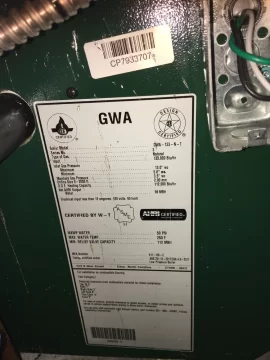

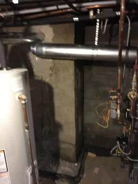

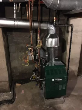

Here is the new furnace...it’s not plastic and looks like water heater and furnace go to chimney

You have a boiler setup that I completely missed in your info/pics. I was speaking about forced air systems. Different animal. My comments likely have zero bearing on your situation. Apologies if I wasted your time!

Just to clarify that is a boiler, not a furnace.
Why is the plumber installing an ~80% efficient boiler, when there are far better 95% efficient condensing boilers available? You could have even got a combination boiler/water heater and got rid of your water tank too.
These condensing boilers are also direct vent using PVC and are commonly vented out the wall, which would avoid your chimney issues.
My bad for calling it a furnace....I didn’t realize. I know the water heater is only a few years old. I have no idea why he chose the less energy efficient boiler...after I had the chimney capped and that guy took a peak and said the chimney was too small for liner I would need I asked the plumber what type of boiler he ordered and if it was energy efficient and he said no he didn’t find it really makes a difference. That was the answer received. Again since I have no plumbing knowledge i feel like I’m stuck in the middle of a mess of confusion here And I’m concerned it could cost me both safety and money.

He's right that you probably won't notice much on your bill. Maybe he thought that the labor would be cheaper this way, but if you need extensive chimney work this won't be the case.
If the inspector says the current install is a no go, ask the plumber what it would cost to swap that boiler for a direct vent condensing type, at the end of the day he/she installed a boiler that does not conform to code and should be at least partly on the hook for the costs to make it right.
The majority of our local plumbers install Navien brand condensing boilers (I have a Navien hotwater heater in my house), and from what I can see online are similar in price range to the boiler your plumber installed, this may be a cheaper option to have the venting run out the wall. There will of course be piping modifications required to hook this up.

If the inspector passes it, then it should be fine because it meets code. Right now it sounds like the inspector doesn't want to pass the install because the chimney is too small to meet code.
I'm not a chimney expert, but to my understanding this type of appliance needs to be vented up to the roofline, it relies on the heat from the flue gases to draw them up and out of the house, this has to happen either through the existing chimney or through a new one. It can't be just vented out the wall.

That is a fine boiler.. there are many reasons to go with the lower efficiency. Depending on your fuel costs and heat load you may not get much savings from a higher efficiency one, and also your service calls will be cheaper and easier with the 80% unit.
This boiler requires a type I vent which is negative pressure non-condensing. A natural draft chimney works for this, or you can vent it through the wall with a power venter.
This is where a condensing boiler differs, it cools the flue gases down enough that it can safely be vented through PVC pipe. The system doesn't operate on draft and instead uses a blower within the boiler to pull in fresh combustion air and to push the burnt gases outside, making wall vents possible.

Yes I would think so. I don't know about the rules where you live but in my area the plumber who installs it should perform a combustion test and a draft measurement. If all of those are in spec for the appliance then you are good to go. If the liner is indeed too small then the draft reading will be low.

I see...I guess maybe the chimney was considered to be fine for the old boiler but maybe code changed. The fire inspectors passed the CO2 detector requirement during the home sale but I think I will add some more for peace of mind
