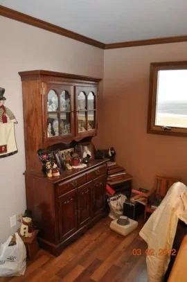

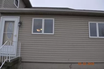

Here are pictures of my proposed location...sorry for the clutter...that corner seems to be one of the family "catch all" spots.
The edge of the window is 32" from the corner. I think that window causes some problems huh? Would direct horizontal, staying below and to the side of that window be better?

I would be all for a 2nd stove. The CPM would be a great unit for you...
You could burn your Corn from the furnace or Pellets that you have for your Baby already. Win/Win....
As for the Window. Going 1 ft above would be best. If you stay below, it has to be 4 ft below window.
Also. Englanders need a 3 ft rise anyways, so just take it up a couple more feet?? No??

To get above the window, would you vent directly outside....horizontally far enough to extend past the eve...and then up to just over the gutter?
The reason why we say to go up then out on the inside is if you ever get another stove you can buy an adjustable piece to make up for the height difference between the stoves. If you have too you could go straight out. Then add the rise on the outside of the house to get above the windows.
How about the corner where the hutch i? Looks like that would lend nicely to a corner install. And away from windows too.
Yes that's the corner I want the install. I'd love to go up on the inside and then out, but I can't really get above the window as seen in the 2nd picture. The window that is 32" from the corner in pic #1 is the same window just right of the front door in pic #2.

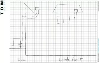

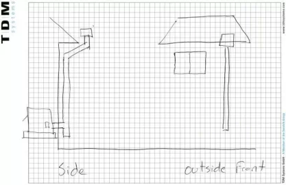

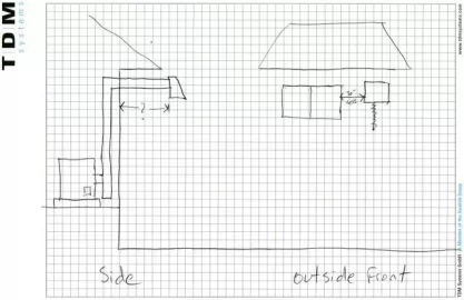

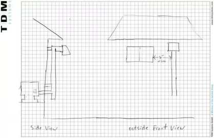

Due to location of the window, I'm concerned about the termination cap in relation to it. Which of the following is the best option?

Its not ideal for another stove later down the road, but if your gonna use 3" vent, then I.would go straight out and up. I would go straight out a couple feet, so I.could go straight up, without an off set at the top.
If you can do 4" (recommended) then maybe I would do the offset. With 4", you could pretty much run it out however you wanted then.
But because you have only 30" of clearance. You have to go above the window. (Unless you buy a Harman, only needs 18" with an OAK) ;-P
A couple different Manufacturers have reduced clearances with the addition of an OAK. Englander is not one of them.

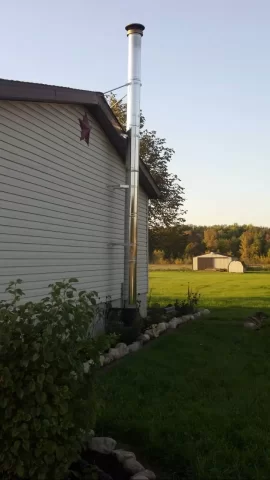

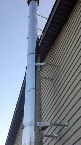

My Brackets...
