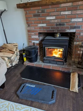

I have a 1930, 1500 sq ft colonial. Somewhat insulated with blown-in insulation 30 yrs ago, and new windows. I save 75% off my natural gas bill for my boiler. I installed the stove myself so the whole thing cost ~$3000 and I have never paid for any wood in 12+ years. So it paid for itself in about 4 years...maybe 5 after some chainsaw upgrades ;)
My kids were about 5 and 2 when the stove was installed. We mentioned a few times about hot it was and not to touch it...they never did and we never had a problem. In fact, they stil don't touch it (I really wish they'd show some interest in building a fire!) . The only risk was the errant toy or paper airplane that I'd find behind the insert for time to time.

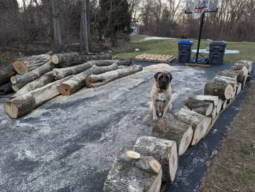

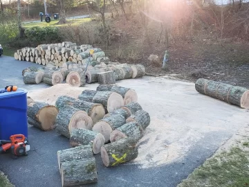

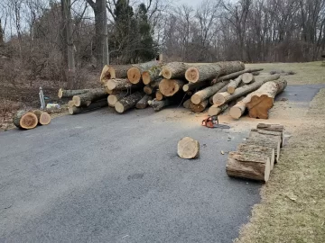

Here are some wood processing pics:
