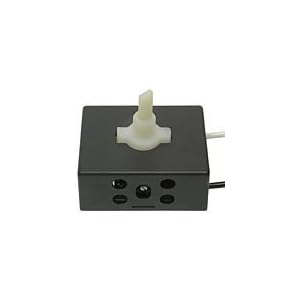

Yes, that is a rheostat or fan controller
http://www.amazon.com/KBMC-13BV-H90...5892749&sr=8-63&keywords=rheostat+fan+control
[Hearth.com] Convection blower only works on high?
The set this switch, once wired, turn on and turn it all the way to the lowest setting. See the little white screw there in the center of the five holes in front? turn that clockwise until the fan stops moving, then rotate counterclockwise until the fan flades freely move. That will be your low setting. Everything else turned up will be a graduation up to full speed.
http://www.amazon.com/KBMC-13BV-H9034-Solid-State-Control/dp/B007YA2UAC/ref=sr_1_63?ie=UTF8&qid=1355892749&sr=8-63&keywords=rheostat fan control
You will resuse the knob and the lock nut from your other controller on this new switch and you will also need to attach two new disconnects to the wires
This is also helpful. I am bookmarking this thread. We have to order the new rheostat. I will make sure that The Husband knows of these two new disconnects. Thank you again!
