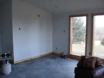

Thanks Zeta. Why the 50/50 mix? Just to keep things cleaner? Isn't the Prescott a full corn burner? This corner is just waiting for a stove.
  • [Hearth.com] Corn and pellet stoves
You are welcome Galen. The Prescott is a pellet stove.
The operation manual says it can burn up to a 50/50
corn pellet mix - so we do.
There's a link to the different model St Croix stoves.
(broken link removed to http://www.eventempinc.com/stcroix/stoves/stoves.html)
btw, that corner certainly does look like it's begging for a stove! :-)
