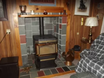

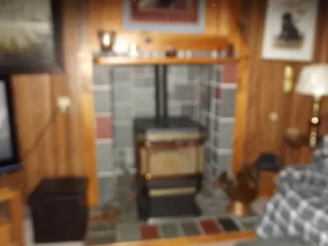

Are you leaving the fireplace in or removing it?
I had an 0 clearance fireplace took it out reworked
the 6 in class a chimney and install the stove in the opening
But I have many skills master of some
