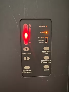

I have an Enviro Mini that was installed in 2023 (in my mother-in-law's in-law suite apt.), and it get's serviced by the same folks that installed it. I'm having an issue after the stove was professionally cleaned yesterday, where the stove no longer turns on/off properly in the Auto/Off mode using the Thermostat. The stove was running fine before the cleaning, and never had issues after my normal weekly cleanings.
The stove will feed at start up and I'll get a flame. Right around the time the stove starts to blow, there's an audible "click" and the stove starts to wind back down, and will burn the pellets in the burn pot in it's shutdown phase. The Mode light will blink steady, with the #3 light blinking steady in tandem. The hopper is, obviously, not empty and it has a newer ignitor (it failed in 2024...so much for made to last products!) and there is a flame, so it can't be the Fail to Prove Fire problem.
The technician states he did not change any settings, but something is definitely up. I figured maybe it was the combustion trim rate blowing too hard and causing it to flame out, but when I hold the combustion trim button, the mode light never goes solid so I can't seem to change the trim level (or the feeder trim). They offered to come back out to check on it, but I really don't feel like being hit with a service charge for a visit right after paying for two stove cleanings. It runs quite a bit better in High/Low, but the space is too small and it gets way too hot...so that option isn't really a good fix.
I'd like to put the techs feet to the flame but I'm just not sure what's up. Any ideas of what could be wrong would be greatly appreciated.

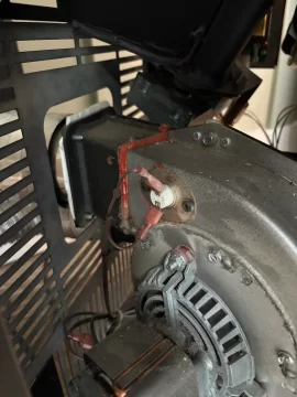

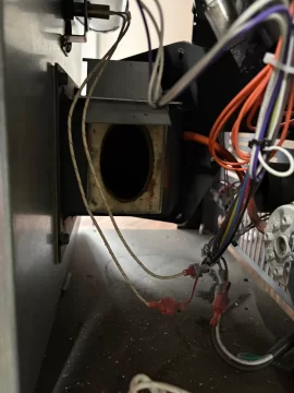

Update: Opened the stove up this morning, checked to make sure connections were good. Everything looked okay, however the type of connection on the Exhaust Temp Sensor isn't really the kind I can jump/stack like in the Tech Spec Manual to bypass.
All the fans are working fine, Auger is fine, no blockage. Fresh Air Intake at the Exhaust housing is open. It will run in Manual fine, it's only the two settings associated to the use of the Thermostat, which makes me think the stove is fine and there's something wrong with a sensor either on the stove associated to temperature or the thermostat.
If I force the stove to continue when it starts the error, it seems to work fine through the room reaching temperature and then shutting down based on room temperature. The real issue seems to be when it's cooled a bit between running and it will throw the error right about when the stove gets hot enough and the room fan turns on (again, only after it's cooled between running cycles). The damper is in the factory position and the flame is good when it runs in manual or when I force it past the error. So stumped at this point!

Watch this jumper wire vid, you can also just use a paper clip jammed into both spades. Remember unplug stove before you do it and tape the connection do not let bare wires touch body of stove when stove plugged in it will kill your board.
Reactions: Burnin Since 1991
As said above, check the Exhaust Temp. switch
Start by removing it (2 scews) and clean the face
A coating of ash will stop it from working right.
Start the stove and test to see if it keeps burning
If it does, you are good. If it stops again, jump the
2 wires and retest . If the stove operates as it should,
replace the switch. 9 out of 10 times, it is ash insulation
stopping the switch from obtaining operating temperature.
