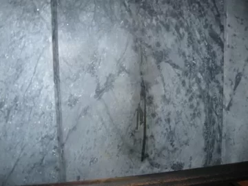

I've been burning less than 2 weeks and I have a cracked stone... center rear. I did 3 break-in fires and the stove has never been overfired. Max stovetop temp so far is 550F. I don't think I've done anything wrong operating the stove. I don't have to leave the door open to start it, the ash door is fully close, shutting down the primary air works as expected (almost all combustion is from secondaries). Maybe I heat it too quickly. I burn a good amount of pine and it gets hot quickly. I generally run with the door closed and the primary wide open for 15-25 minutes before backing off the air. I do monitor my stack temp, though, and have never let the internal flue temps go past 800F.
I'm not the kind of guy who abuses my equipment. I drive with a light foot and I take care of my stuff. So if I'm doing something wrong I'd like to know.
I'm not overly concerned as I checked with a smoking match and the crack isn't leaking air into the stove, but it is frustrating.
I'm glad it's on the rear of the stove... with my setup nobody but me will ever see it.
Would you guys try to replace the stone or just keep and eye on it? I'll check it's all the way through next time the stove is cold.

johnstra - can you post a pic of the crack? I'd like to see what you are dealing with. If it is hairline, I wouldn't worry. Perhaps some refractory cement on the inside of the stone, and then forget about it. But, if the crack is significant, I guess I'd look into replacement. Can't be cheap, and I've never heard of the stones being under a lifetime warranty (but I sure hope it's true!!). Cheers!

I am loading N/S, so I can't rule out the possibility that the crack occurred during loading, but I'm pretty careful - especially with the caution in the manual about the baffle being fragile.
I'll get a picture posted up when I can. It's kind of awkward getting a camera back there.

Here's a picture. I have no idea what's leaking out of the crack. I spent 30 minutes this morning exploring the inside of the stove and I can't find any sign of a crack on the inside. I assumed this was creosote, but I don't know where it would be coming from. Could this be something inside the stone?

That crack is a through crack, a failed stone. Otherwise it wouldn't leak creo. The crack may plug up with creo or it may flow like that and make a mess forever. It is not a surface crack and I believe it would qualify for "needing" replacement if you demanded it.
If I was you, happy with the stove and out of warranty I would wait and see. Keep an eye on it. Try smearing some cement on the inside after you clean the stone really well. It could be worse after the professional repair. In the summer, reconsider your options.
