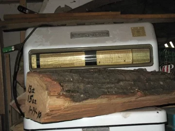

What can I say? I am one wild and cuh-razy guy! After all, just look what I did last year in the BattenKiln in less than 3 weeks:
  • [Hearth.com] Crazy wood drying idea?
