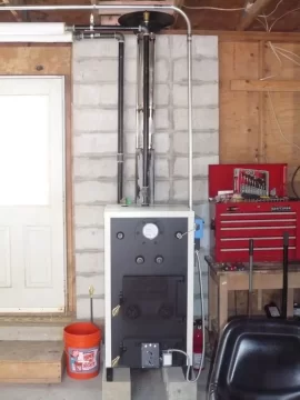

I've been running my Harman SF-160 wood boiler for about 4 years now and every year I have a lot of creosote buildup. This year I have insulated my garage where the boiler is located but now the creosote buildup has increased and the odor which used to escape from the eave vents has no where to go but into my house!! I am burning very dry wood that is covered and stacked so it's a dry as can be for eastern Connecticut.
The buildup is so bad that it leaks out of the chimney over night when I turn the thermostats down which idles the boiler for most of the night. I woke up this morning to a pool of liquid creosote underneath the stove pipe and streaming to the middle of my garage floor. Yuk!! Worst of all my wife equate the creosote smell to cigarette smoke so now she's not happy. The garage insulation has greatly improved the efficiency of my stove since heat loss is contained rather then venting to the atmosphere but now I have to deal with this smelly problem.
My stove has a 6" flue diameter. I run about 5 feet of single walled pipe out of the back of the stove and up to the ceiling where it becomes double walled pipe for another 10 feet (so 15 feet of pipe total). The single wall elbow coming out of the back of the stove and the 5 feet of singled walled pipe have to be changed every year because the creosote rots them completely. The double walled pipe is still in great shape and never builds up any creosote at all except at the chimney cap.
Is there anything I can do about this? I'm well aware of the flammability issue with creosote and the hazards associated with that but I also need to deal with that smell too so now it's A1 priority to reduce it. Do they make double walled stove pipe for the interior or stove pipe that is better sealed so the creosote doesn't leak out everywhere? If I can keep it contained in the stove and chimney I think I can reduce the smell considerably.

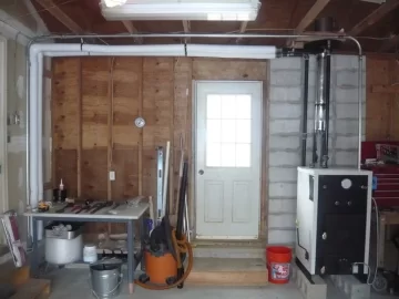

Take a look at these photos of the stove prior to me insulating the garage. You can see the creosote weeping out of the pipe. Since this picture, I now use one single 5ft section of pipe and a 90 degree elbow. I have tried both galvanized and black piping.

Replacing the single-wall with insulated pipe might solve your problem, since creosote condenses out of the smoke when it cools prematurely (i.e., before it gets into the insulated chimney). Insulated pipe should keep it hot enough to avoid that.
You may have a partial blockage in the pipe or further up the chimney, causing the smoke to linger longer in the single-wall section of pipe, increasing the amount of creosote condensation compared to what you experienced before. On the other hand, insulating the garage should have helped the problem instead of making it worse. I'd inspect the pipe and chimney before doing anything else. If they're both relatively clear, I'd consider investing in some double-walled insulated pipe.
Maybe somebody else has a better idea. That's just my take on it, for what it's worth.
It is the idling that causes the creosote build up. The only way to "eliminate" it is to burn dry wood, and don't allow the boiler to idle. You state you burn dry wood already so you need to focus on how to keep the boiler from idling.

I guess I just really need better stove pipe to prevent the creosote 'stench' from venting into the garage or dripping onto the floor. Are the joints in the double walled stove pipe sealed differently than the single walled? Is there such thing as an elbow that can't be adjusted and therefore has NO joints that can weep air or creosote??
What direction are the joints in your pipe running the top pipe should always go into the bottom one that will help with the leaking but that wont fix your problem. To fix the problem you need to change your burning practices or setup like 98 said
Could try not turning your stats down at night.
And/or not loading so full at night.
Plus also sounds like your pipe is assembled backwards like the last post mentioned.
Yeah pipe is backwards. But it also leaks out of the many joints in the elbow as well. My local fireplace store suggested putting hi-heat RTV along the joints of the eblow.
That wont work rtv wont hold up to the heat. And yes there are several types of fixed elbows. But again none of that will actually fix the problem it will only make it not as visible

I have the same boiler. I run Insulated pipe and do not have any creosote build up in the exhaust pipe at all besides a little on the bottom of the chimney cap. I also turn my heat off in my house during the day and then build a fire when i get home and run the system hard all night. I also don't use it on warmer days i use my NG Triangle tube boiler. The big problem is idle time with the boiler it does not do well at all with idle time and with exhaust temps lower then 350-400F
