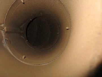

I showed this photo on the other creosote thread. It shows my lower flue up to and including the elbow just before it turns into the thimble. It was taken about a week or so ago, after I had burned 4 full cord of wood. The photo was taken by sticking a camera up from inside the stove and firing away until I got something that was in focus. The shot was taken just how I found the stove at about 10 AM after a long overnight burn finally got low enough to get inside there. There is a very thin haze of fresh soot from the night before, but it is mostly ash carried up from the stove. I'm sure that after I got the fire going good (about 550-600ºF for about half an hour) all of that brown turned to white just like the griddle top and damper plate get. I don't know how many cups of soot I'll have, but this can be done with a non-cat, non-EPA stove just by diligently running it on the hot side.
