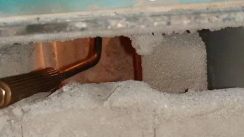

I have a good trick to super easy starting and maintaing good gasification in my Ecomoburn , I let the ash build up in the upper loading chamber to about 4''-5'' deep , it tends to make a nice tapered , self maintaining , hot coal burning chamber and prevents a big split from causing problems with a nice secondary burn . This tapered space is a perfect place to drop your small scraps of wood directly into and avoide use of paper to start a fire , if you don't mind using a good old soldering torch directly up into the nozzle .

Took a piece of kiln dried pine about 1x6x30 and whacked it into 1" wide pieces with a hatchet, and then stomped them apart in the middle to half length. Piled them criss-cross over the nozzle. Threw a bunch of very, very short end pieces of 1x6 and 2x6 cut-off spruce and hemlock lumber scraps on top of the bits of pine. Put some very small splits and branchwood over that. Lit it from the bottom with my torch- left the bottom door open- went do to something else for 3 minutes- and suddenly heard something sounding like a diesel hotrod truck thundering past the house- went back to peek at the boiler, and it was Roaring! kicked on the fan, closed the bypass damper, and immediately had a secondary flame the likes of which I'd never seen before.
Not sure how much of this is due to the cubist method, or how much is that I did not have time to rake out the top chamber's ashes, as I'd previously thought was a good idea- but Anthony seems to suggest that the ashes may be beneficial, within limits. Whichever variable it is, this is the best light-off I've seen yet, so one or the other of the factors (or both) seem promising.
I clean ashes down or out every week or so but "so" could be two weeks with dense hard woods. If I burn catalpa it's usually every couple of days and pine is 3-4 days. Like Anthony the ashes in my primary make a "nest" for coals and kindling but my refractory is usually hot because I'm burning 24-7.
You found the sweet spot for lighting the Econoburn , their is no turning back now . Once you let the ash make a pre fire chamber a 100 second form torch to serious secondary combustion is common occurrence for me .
Anthony
PS A powerful torch tip and not being afraid of blasting the wood from the bottom is my secret .
