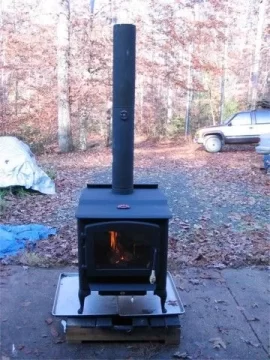

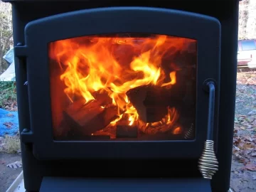

Getting a draft started is the hard part. And because of that you will probably have to keep the door cracked to keep it burning good. But it has been done. As to temps. Crank it up and watch the fumes come off of it. You ain't gonna hurt a steel stove getting it hot. This ain't one of those dainty rocks or piles of cast iron. :lol:
  • [Hearth.com] Curing finish outside?
Thanks for all your advice. I've got the double wall I'm using up to the adapter, so I'll use that.
As far as a cookout goes, I don't know if anyone will want to stand around in 10F weather to wait for burgers. :lol:
The biggest problem I had doing it in November was brushing the leaves off of it all the time as they fell.
When I cured my Summit outdoors last summer I started with approx. 6 ft of single wall, and the stove would not draft at all without the door open. When I added another 5 ft it came to life, and burnt great. My stove really needed the extra feet of pipe, especially in 75-80 degree weather. With the short pipe I would get a good, hot fire with the ash clean out open, but it would almost go out when I shut it, even with the primary air set to high. I was amazed at how sensitive this thing is to chimney height.
