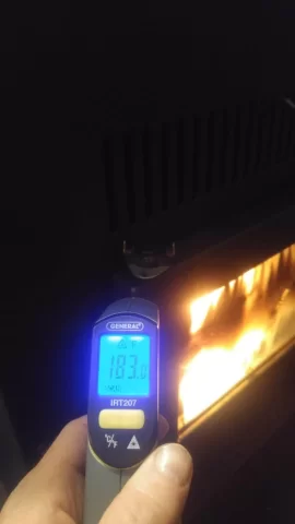

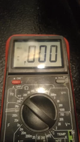

4. L120 Snap Switch (POF?) pulled and tested to be functional.
5. Both fans "jumped" to determine effectiveness.
6. Temp testing throughout internal and external unit.
Findings:
1. L120 Snap Switch functions: heated to 120+ yields 0-ohms, returns to 1+ after cooling.

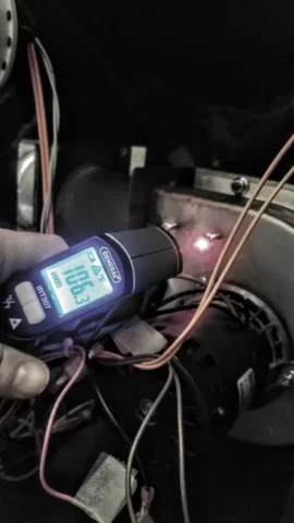

2. Combustion fan housing temp tested and noted to only reach 98-108*!!
3. After "jumping" the fans, unit works fine, so far....

2. Combustion fan housing runs much cooler than required for snap-switch to engage... relocate switch?

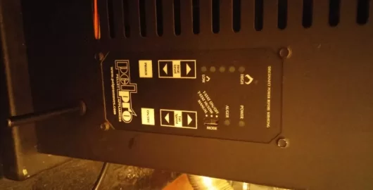

4. What control board do I have; PelPro informs me it is no Accutron, PelPro denies knowledge of my Model # or S/N...
