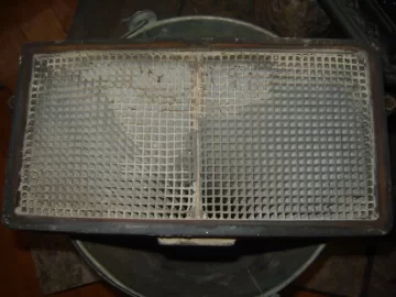

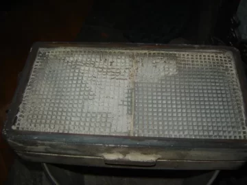

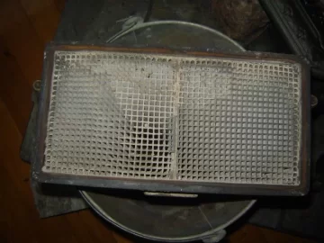

Last winter, being our first with the Fireview, was a learning experience for us. It took some time to get used to the idea that there should not be raging flames in the stove. This learning took its toll on the cat combuster. I had it out for cleaning over the weekend and looked pretty beat up. Dusting it actually caused it to crumble. I put it back in and reloaded. Since then, the cat is clearly not working. Heat is way down, burn times are shorter, there is smoke coming out of the chimney, and the fire just doesn't look right. I called Woodstock on Monday and one of the new stainless steel ones is on the way. It is amazing how much of a difference the cat makes in the performance of the stove. Dead cat pictures are attached. I knew that it was pretty beat up going into this season, but figured I'd see what happened. I had a feeling that it was in bad shape because it was taking longer and longer to light off. As it got worse and worse we probably accelerated the degradation by using more and more heat to get it to light off. Thankfully the combuster is covered by a warranty so our learning experience only cost us $13 shipping.
While I was on the phone with Woodstock I asked if they were going to offer any kind of trade in/upgrade deal with the new stove. Unfortunately, the answer was no. Maybe we will have a 2 stove house soon.

I pretty much did the same thing to the original cat in my first fireview. I originally thought my less than perfectly seasoned firewood did the number on it but now I'm not sure. The replacement and the cat in my second fireview are doing better but they both are showing some minor cracking. The seasoning of the firewood should no longer be an issue as I am 4+ years ahead now.
I sure am interested in seeing how the new stainless cats are going to hold up because I think I'll be lucky to get more than 3-4 years out of the ceramic cats even with perfectly seasoned firewood.
I wonder what is worse for the cat- burning less than perfect wood (to much moisture content) or running with very little flame in the firebox and a red-orange glowing cat.

I replaced mine after the first year also but it was more the stoves fault than mine. The air slide was off it's track, must of got bumped during shipping or something, and it caused too much air to get in there, also warped the cat scoop. The cat was cracked all over, started to crumble and was smoking. Talked to Woodstock, solved problem and they sent me a new cat and scoop.
The following year I was paying real close attention to the cat and it started to crack but no crumbling and still worked fine. I was getting a little paraniod and told Woodstock about it and they sent me another new cat.
I have hairline cracks in this one as well but it's been working fine for 3 years so I'm not going to switch it out til it falls apart. I think it's normal to see some small cracks, the frame around it will hold it together and should keep working.
The new steel cats should be resistant to cracking and I bet Woodstock will save some dough in the long run by switching. I'm really tempted to try one but I'll have to wait.

Woodstock claims they have tried ruining a cat with wet wood and couldn't. I think it would plug up fast with wet wood but direct flame contact and high heat is probably the worst thing you could do for it. By the looks of Flatbedford's cat, he was sucking in some flame. There has also been some discusion about potassium in the wood that breaks down the catalyst and there is something in the works to neutralize this.

Good point about the air slide.. I noticed mine was off track at some point as well - perhaps that killed the cat. Have not noticed a warped scoop but perhaps I should check that out. Both the newer cats have the hairline cracking but nothing falling apart or crumbling. Hopefully they will stay functional.
Wow! More "enlightened self-interest" points for Woodstock! I can easily imagine a more short-sighted company making the customer pay. Great to hear.

That looks like my old cat which died from flame impingement. The way the stove was designed it was right in the flame path with only a piece of steel mesh to keep the flame off of it. I did not know how important that mesh was and as it degraded more flame was able to hit the cat.
