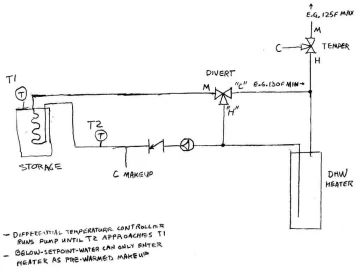

Affordable differential thermostats from the solar panel industry make for some ideas I hadn't considered before.
Does this seem workable?

Yes the diverter valve could be any adjustable three-way thermostatic valve that is also suitable for diverter applications, e.g., TACO 5000 series or something cheaper if I can find it. I don't think Cv is a big deal here.

With either you can adjust the pump-on-delta-T and pump-off-delta-T, and I would guess that with a 10K thermistor and even an 8-bit A-to-D they should be good for better than one kelvin resolution assuming they picked a pull-up resistor in the right ballpark.
