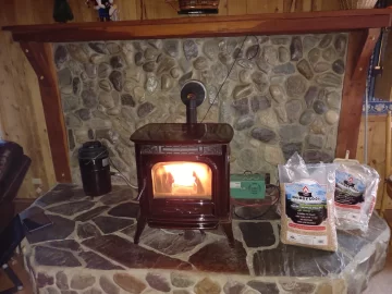

When I got my Harmon XXV in May 2018 I got floor model. $3500 with tax. They dump them come very early spring. I just put in Extreme Weather Heat pump (Down to -20f - Madea G3 Evox, 16k). No major problems with Harmon. Some buzzing with couple of screws on distro fan is all. We have to use couple box fans to move heat down the hall. Plus some Elec Heat. So far Heat Pump is working out, but only down to 24f has been the lowest temp. Look for someone flipping house or Estate Sale! I hope to only burn 1 ton of Pellets vs 3 Tons normally. Jury still out!
