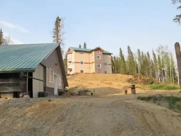

bird view of shop

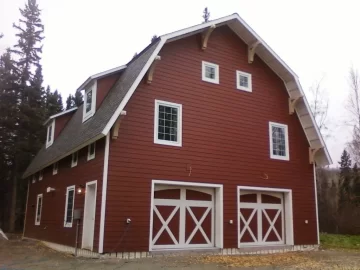

Here's an older pic of our house (barn) while still under construction. That was about a 1 yr ago. I can safely say it's the only barn like this in Fairbanks! LOL
That is a nice barn. Don't do pm. Others can/could learn a lot as insulation tends not to be to recognized in the general public.
Stihly...
Thanks for the compliment. In Fairbanks you learn quickly about insulation and heat loss! LOL. Our energy cost are outrageous!!! I'm sure ATV will attest to that!

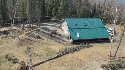

bird view of shop
I admire a man that does a job correctly. Snow cleats above all your roof penetrations! Nice. Can't believe how many build here without them and then stand in utter amazement and disbelief when snow breaks and pulls everything off of their roof! Very Nice!
agreed .........dammm that's a clean looking barn ya got there!!! I moved from the farm amd out of the barn out of high school ...now their following me !!!
Reactions: alaskawild

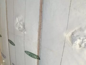

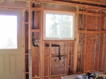

this is what I have for insulation high density blow in glass 2x8's 2'oc [Hearth.com] did some math on my shop btu's.... [Hearth.com] did some math on my shop btu's.... here in a shot of the kitchen window ....the vent for the kitchen sink is the only thing in the wall ...the drain stays inside the envelope AND the vent comes back in the ceiling , to hook up and exit from inside. Look close, you can see that every stud bay is calked and spray foamed EVERY seam ( I mist the bays with warm water in a garden sprayer - if makes the foam expand more = u get twice as much from a can (I use the 50$ gun) it dries harder and faster ...only works with single component btw) every plate was foamed just before standing the wall- all the electric wire holes and the penetrations into the receptacle boxes ...like building a 2700 sq aquarium...yet it can breath air to the outside with all the siding nail holes! ...it just can't move around in the bays and wash the heat from the walls BTW .....if u hit control + on your pc u can look at things up close ..even closer if u keep hitting the + sign ....>just a tip in case u suk at a pc like me lol ;)
