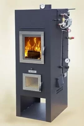

    As the US distributor for this product I posted some pictures of over a decade long evolution and design changes for this particular decorative indoor wood boiler gasifier.
    It also gives you some ideas on how to incorporate a fire viewing port.
    I do not recommend to do it in the upper firebox becasue you probably don't have any provision that will keep the glass clean.
    It is easier done in the lower firebox where the gasification happens.
    You will need to use a double or trippled glazed veiwing port to prevent that the temperatures drop to much.
    See first and second picture.
    walltherm-rot.jpg ag_2.jpg wallthermarmaturen.jpg Holzofen-Wassertasche-Kachelofeneinsatz.jpg wallthermerstesbild.jpg
