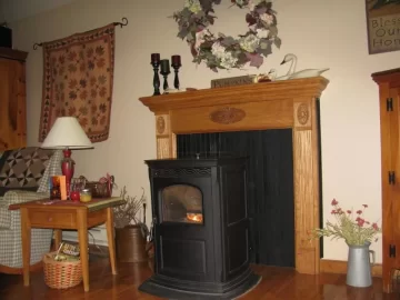

Just cleaned mine today also . Yes it's on a surge protector hidden to the left behind the watering can.
