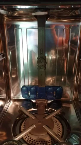

I have a Kitchenaid dishwasher that the bottom half works, but no water pressure is going up the tube to the upper rack to clean the dishes on the upper rack. Annoying, I just fixed the upper rack the other day.
Has anyone encountered this before? Here is the pump diagram.... Kitchenaid Model KUDS301XBL1
http://www.partselect.com/ModelSect...sition=9&mfg=Whirlpool&Type=Dishwasher&Mark=9
Thought it might be a pump but I think it has only one. Check valve?
I took the upper rack off and am only using the bottom...

If I'm remembering correctly there is an impeller under the lower spray arm that sends water to the upper spray arm. The gray 90° piece in the back should have a valve in it also.
The impeller is usually the culprit though, I think we've replaced 3 on my parents.

It was the grinder wheel assembly. Took 15 minutes. It was a $17 part.
There were seeds and things under the cover that houses it. The grinder was kinda blown apart and wasn't turning. Took out what I could by hand, shop vac, installed new grinder wheel. Top is now getting water. 5 Torx screws.
Think I'll do a empty load with bleach, get one more seal for the upper water tube, which is easy to replace, and call it a day. I imagine with the upper rack repair and the wheel I saved myself around $300.
