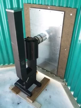

There are a few gravity fed, no electricity stoves out there. Shortly, there will be another manufacturer once I get my act together.
Have you checked out the Prairie Dog Stove system? It's on my summer need to get list.
You didn't check out the Ice shack heater? [Hearth.com] Displaced and Needing Direction
