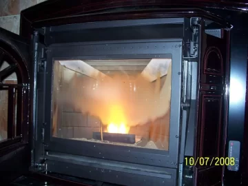

I have a enviro empress FPI installed in a two sided fire place with the back of the stove open and without the OAK. I have been running it with Lignetics pellets (they do not have good quality control on the size of the pellets. Some are over one inches long) and trying to adjust the damper to get the most efficient burning. I am getting lot of ash (the ash pan is full after 2 bags) and dark orange film on the glass. Could this be prevented with installing OAK? I went to Home Depot and found that the Fireside pellets have smaller pellet and I might try these. I am including a picture of the glass. Is the glass leaking air? Please help.
