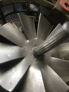

Joe can you post a picture of your motor? Just so we know weather its an open or closed frame motor.
that is an open frame motor. the only problem with changing bearings is you will have a difficult time getting the pressed on cooling fan blade off the shaft to take it all apart. they tend to get bent up getting them off. ask me how i know. lol but if you can get it apart successfully you can get new bearings or try using a sheet rock knife and pop the seals out and repack with high temp grease

Yeah I tried to get the fan off and it was not coming, Otherwise I would have repacked them wasn't sure if there was a trick.
