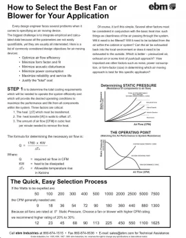

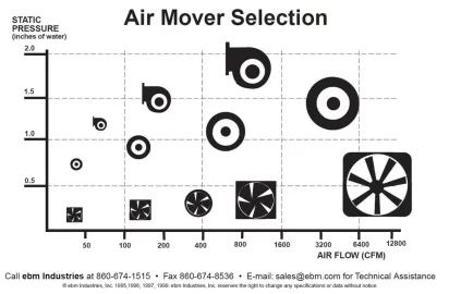

For those with time and patience for "the crazy details" I've attached a technical pdf from EBM-Pabst on how to calculate the optimal air flow in a system.
To awaken the interest on the subject a couple of samples are visible below. Have fun reading;) Very useful info.
[Hearth.com] Do You Have a Stronger Motor For My Stove?[Hearth.com] Do You Have a Stronger Motor For My Stove? [Hearth.com] Do You Have a Stronger Motor For My Stove?
