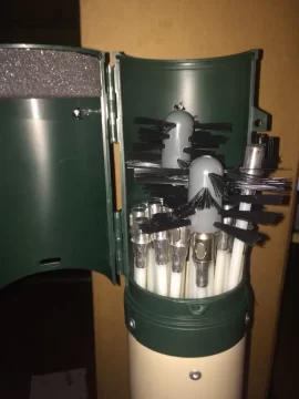

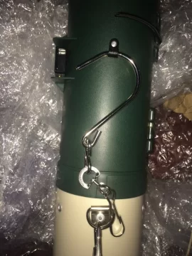

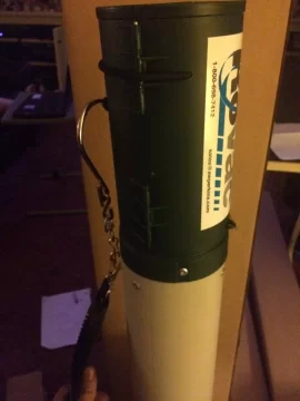

Hi
Finally got mine in!
Does anyone know what that hook and chain in pic 3 below is for?
Hanging the case up?

Hi
Wild guess... maybe to hang it while working off a ladder? Or hang it from a chimney if you you work from the top?

Nice, perhaps it's to prevent the case from rolling around in the back of your truck?
Yes but it was made to hook on a ladder.
