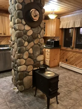

Does anyone recognize this pipe?
johnnyvirgil
Jan 25, 2023
51
Upstate NY
There are no labels on it. It’s 8”. Thanks!

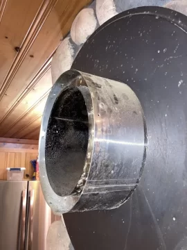

It looks like it might be ICC-EXCEL…

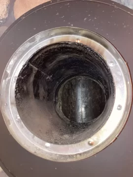

What s does the “male” end of the adjacent section look like?
I can’t tell - it’s all buried in the wall. It goes up through the center of the house in an enclosed fake stone pillar. I’m trying to find an 8” to 6” reducer for it. It doesn’t seem to have any locking mechanism like duravent.

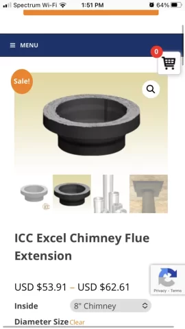

If it is Excel, they make a flue extension, part EX, for connecting stovepipe.

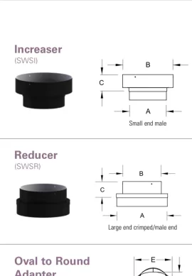

Yes, you would need an increaser as well.
I don't know if the 8" end will seat properly into the existing pipe end. The OD may be too large. Just looking at it, it seems like the Excel adapter may be a snugger fit. That is TBD.
The link is for a Ventis adapter. If it fit snuggly, then it could work if the rest of the connector piping is also Ventis. Check out Rockford, they sell Ventis black pipe and may be able to give you specific OD for that piece.
