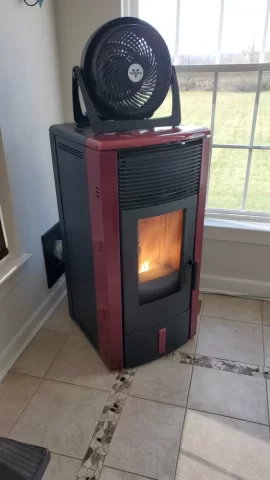

I use a large Vornado fan...those expensive novelty fans don't move much air.
I added a thermostatic disc switch inside the stove to turn the Vornado fan on/off automatically.
This works well to help heat my 3400 sq foot house......the downstairs half is pretty well heated by this 44,000 BTU stove.

Yes, that type of magnetic stick-on thermo-switch is what I used, wired in series with the line cord of the fan. I attached the switch to an internal steel frame section near the firebox. Be carefull that you don't place it on the firebox itself, as that will get too hot and destroy the switch.
