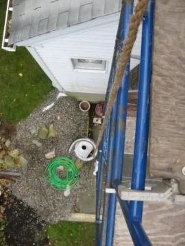

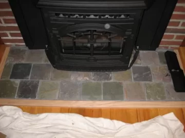

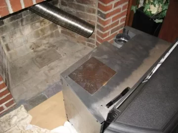

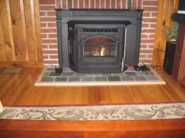

Here some pictures of me doing this myself.

Fish On, install looks great! Congrats, and don't forget to post some burning pics. :cheese:

Beautiful looking setup!
I noticed you have a clean-out door in the fireplace. I ran my electric thru the clean-out door into the cellar to a electric box. That way, the electric cord doesn't show(like you have in the picture). Nice looking setup you have there..

Fish On, don't know if I mentioned it before, but this goes for all the new installs....get a good surge protector on that stove. Minimum of 750 joules protection, and hopefully it also protects all three legs (G-N-H).
Very nice job, Fish! Very professional. Enjoy the heat and the view. :-)

Great looking instal with a very nice stove.
Enjoy the warmth.
Real nice looking setup!
Aren't you glad you won't have burning cinders exploding out of the stove and ruining that great looking floor?
