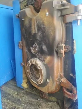

Well i was able to procure 2 Buderus boilers at a good price. They are 5 section and seem to be in good shape. The seller said there are no leaks and all things being equal I will find out this weekend. Ironically I searched high and low for reasonably priced units. Lots of folks think they are worth big $$ for something 10+ years old. Everyone is switching away from oil to NG so took longer to find something at a decent price. Anyone want to help me lift them out of my truck!?

This past weekend it seemed warm enough to spend some time outside working on the boiler project. I thought I had cleaned out the innards of the boiler rather well....filled up the boiler with water and slowly warmed it up. Got up to 200F without issue but man that think spewed black smoke beyond belief. Once it was shut down I opened the door to see a whole bunch more 'oil soot' come loose that was now burning. Gave it yet another cleaning inside and will procure a flue passage brush to better clean those but I think it will need a couple more firings to get the rest of the crud loosened up and out. Otherwise it just may work! Will post a video once I get it all cleaned up and functioning. Plan to work on my auger feed this weekend for it.

Looks like the boiler would be pretty heavy for most trucks although you didn't say what your truck is. Not trying to be weight police it's just that it looks HEAVY, HEAVY.
